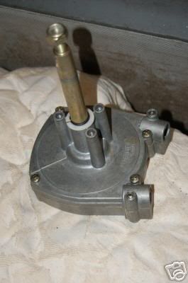

drewpster
Oct 17, 2006
2,059
Re: Backward Steering!!!!!
Try feeding the cable out of the box and feeding it in to the other hole on the box. I know some of the earlier teleflex boxes could be fed either way. If you have it in the wrong hole it will work backwards.
If you can, get a picture of it so we can indentify the box.

drewpster
Oct 17, 2006
2,059
If the 'box' is on the top of the steering shaft, take it off and install it on the bottom of the shaft. Or visa versa. I did it once myself (installed backwards) and it makes for difficult steering. There is nothing wrong with your equipment, its installation error.
This pertains to a rack type helm. A rotary helm is different. This is rotary....the appearance will vary a little.
This is a rack. It will have a flat gear conncted to the end of the cable that bolts to this.

drewpster
Oct 17, 2006
2,059
Rotary can have one cable. The other hole is for the cable to feed out of.

Ok from the pic drewp posted i have a 'rack' system....
I still dont think I can flip the 'box' upside down, it seems like it can only be mounted underneath the steering wheel's shaft...
Am i making any sense?....pics will probably help...
thanks for all the responses thus far!

drewpster
Oct 17, 2006
2,059
Is this a new helm and cable? On my boat I had to install the steering pinion upside down (180* from what the instructions say). There is not a way to rotate the pinion housing without drilling new holes and mounting the entire unit upside down.
The rack does go on bottom IF the helm is on the left side of the boat. As this picture appears.
The rack goes on top if the helm if it is on the right side of the boat.
Pay attention to the action of the cable at the engine end. Thats all that really matters.

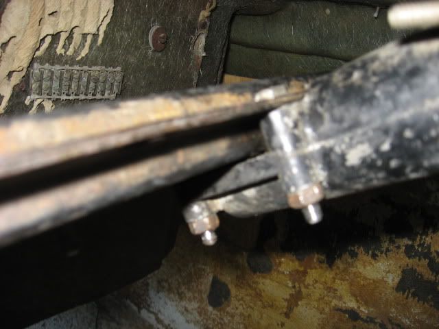

boatflipper
Jun 16, 2009
500
Well folks,
I finally got my steering problem resolved!!
Originally, the rectangular box was mounted on the underside of the steering shaft. I simply turned it, and the shaft upside down, and problem solved!
I attached a picture of the correct way to give you a beter idea of what I am attempting to explain...
