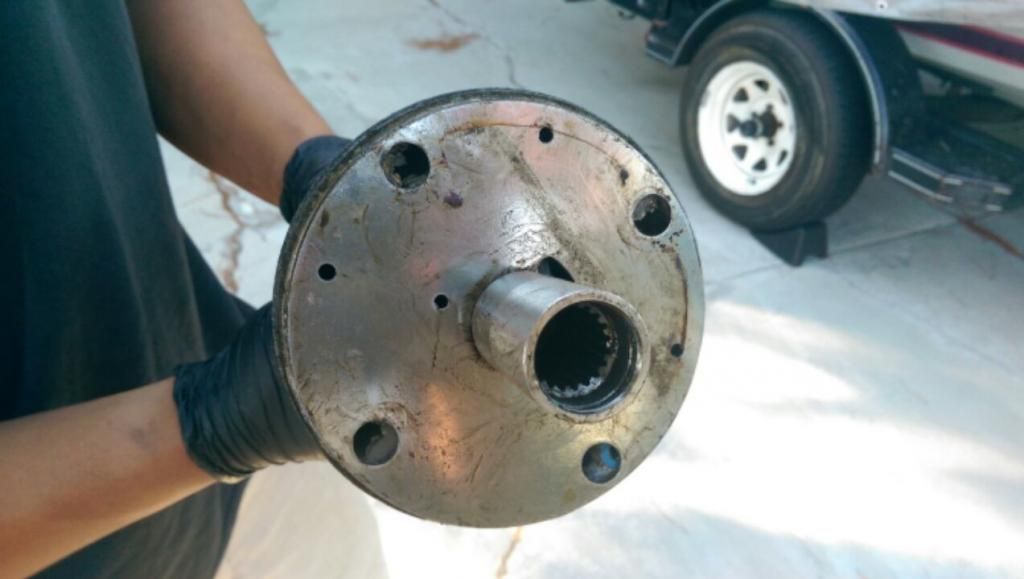

UPDATE: i took apart the upper gear housing and found that the shaft that the water pump and impeller live on. here is what it looks like.
when we tried turning the gear the shaft on the other end does not spin. this leads me to believe that this is where our break is. i was thinking about taking this piece to a boat mechanic and seeing if they can replace the shaft with a fresh one and put this assembly back together for me. i called a mechanic in town and he said they dont usually work on parts, but they would be willing to if we could wait a week because they were so backed up.
after reading the service manual and looking at videos online, it seems that i would need a press and a special tool to perform the fix myself. does anyone have differing opinions on this? any help, opinions, thoughts or info will be really appreciated.

I'm not sure what we're supposed to be observing in your pics. Everything looks ok there (no?).
In your 3rd pic, see that shaft with the female splines on it...
Remove that shaft with the water pump impeller and look at the OTHER splined end. That is the one that likes to strip out due to poor maintenance. (impeller should be changed every 3 years and the splines are greased then)
You are 95% of the way in... just need to finish disassembly.

what i was asking in the previous post was whether it was possible to take the assembly in the pictures apart in a home garage, or whether this is something i needed to take to a boat mechanic to get apart b/c i thought it may need some sort of press that i dont have in my garage, or shop at work.
after showing it to a mechanic in martinez, he gave us some good advice on how to safely take the thing apart, and we were able to separate the two shafts that hold everything together. the lower shaft came off and the impeller and housing came with it. the impeller looks preety new and that it had recently been replaced. sure enough, the splines on both shafts were stripped, and both shafts will need to be replaced. we were able to to get the nut off of the upper shaft next to the pinion gear, but we are still unsure how to remove the pinion gear and the bearings from the upper shaft so that we can replace it.
im hoping someone out there has some tips or advice on how to get the pinion and bearings off of the broken upper shaft so that we can finally replace these busted shafts, and get this stern drive back in working order. thanks again.
