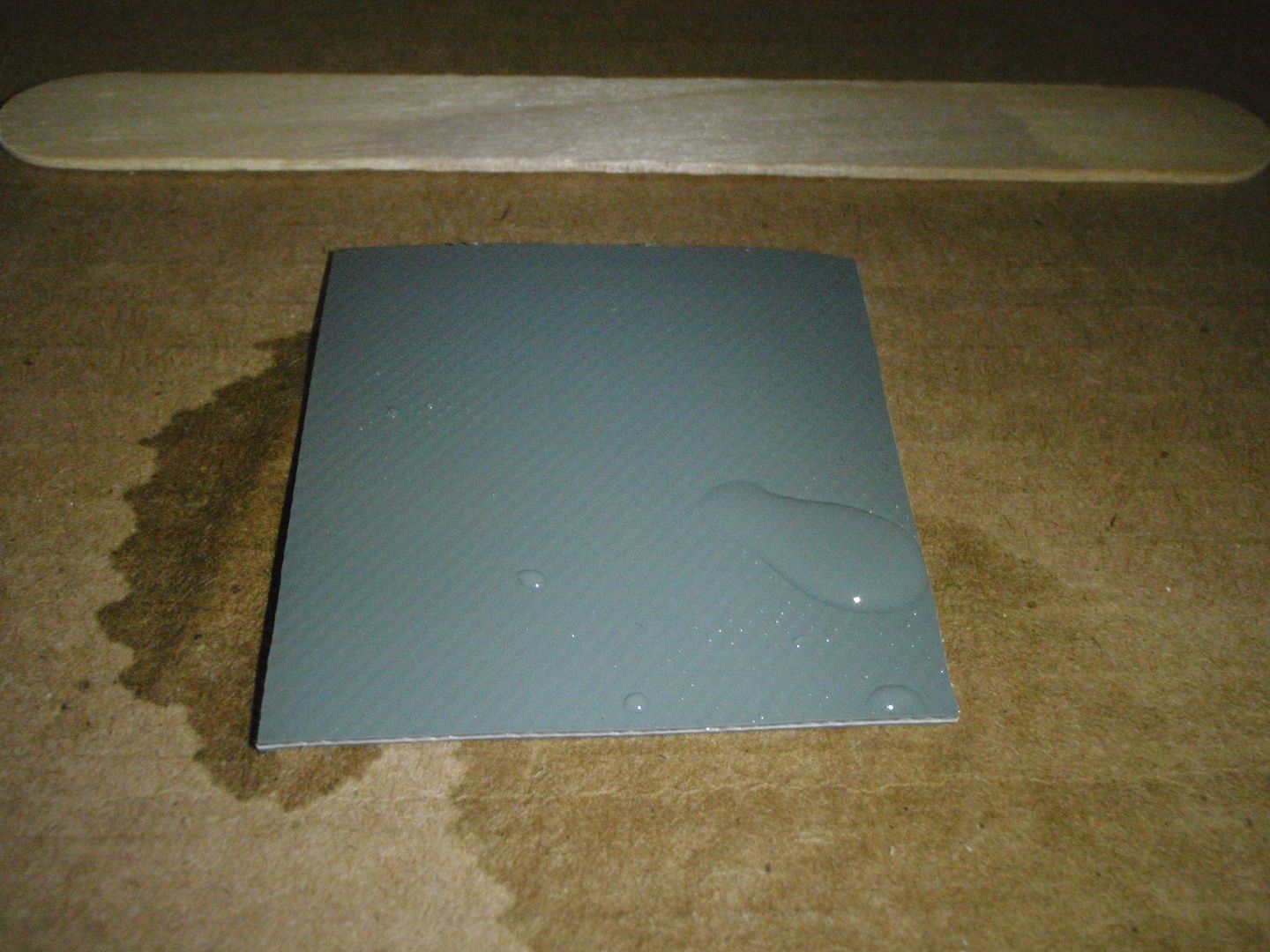

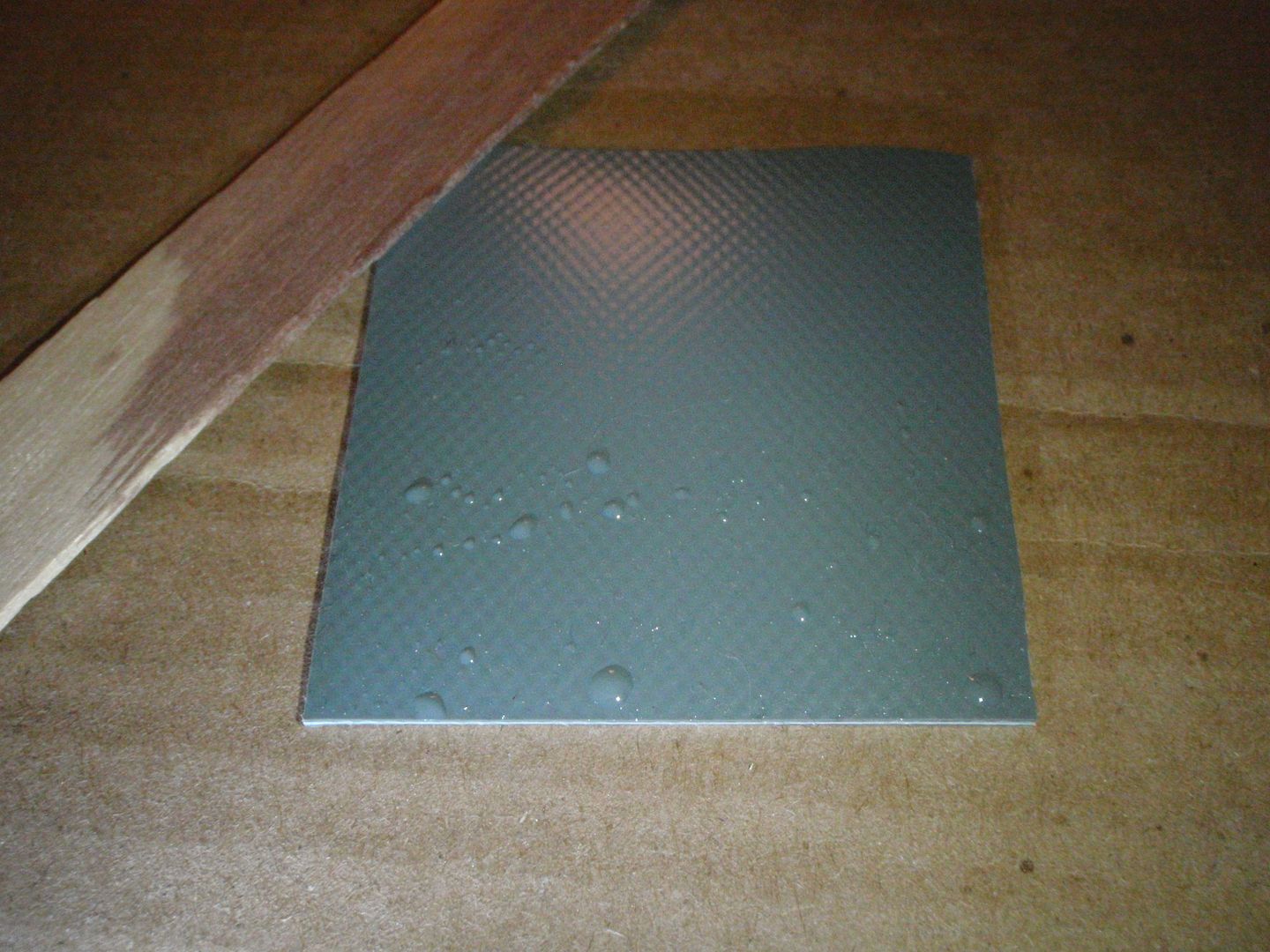

I usually change out my motorcycle battery every year and have excess acid left. I took a piece of repair PVC that came with my SIB and a wood stir stick and poured the acid on them. It's been about a week now. The wood stir stick definitely discoloured and I would guess will be weakened? The PVC shows no sign of anything yet?
A week later...
The cardboard on the second picture is fresh in case your wondering.

That's a surprise, PVC must be a lot tougher than I would have thought. Battery acid certainly eats right thru clothing, shop rags etc.

You can see some of the acid is still just pooled in droplets on top.

Agreed. Carbon chain polymers like PVC, polyethylene and polypropylene are not attacked by acids, but can be softened and weakened by organic solvents.
