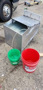

Yeah I was trying to see if there were prefab poly tanks that I could just drop in similar to a fresh or waste tank but with a open top and a lip. It looks like I may be forced to build one instead.

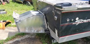

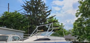

hey i meant to ask how big was spectrum and how did it act with a bracket? i was going to bracket my 17 footer but everyone said it wasn't wise of course a aquasport dont seem to be as wide as those.
huggyb1972
Apr 1, 2013
256
It was a 19' with about a 80" beam.
It came on plane better at a lower speed.
The transom was approximately 2" higher in the water.
My speed increased to 40 with a couple adults and me on the boat. Max before was 36 on the OMC 2.3 TKO.
Handing was good, throwing a tube around was not any harder than any other boat though I could've stood to have hydraulic steering, over cable.
I did have trouble with the engine height I had to add a 5" extension because the power head was to low and was sucking water into the bottom cylinder and causing issues (I think)
