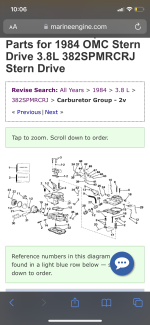

i have not looked at the fuel vent. That did also cross my mind but I never checked it out.
I was able to pump fuel out of the tank relatively easily though from the main line that goes to the pump. I felt no restrictions there when pumping old fuel out. It flowed in a steady stream.
There is a filter on the carb, it is new.
I have not checked the pump/pressure either.
When the pump line was disconnected from the carb and I cranked the engine, fuel would not shoot out in a steady stream, more like pulses.
I figured this was due to because the engine was only cranking or it was a normal amount, enough to fill the bowl.
I am not sure now.
It is a 2 bbl.
