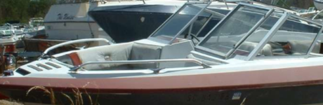

only images I could find spelunking on the web of an early 80s Conroy is this.
pull the side bolsters, make a 6" access hole , then a simple patch panel or a deck cover over the hole and replace the side bolster

Yep, that's my boat. Well, sure Scott, of course I know the correct way to do it ;)
Problem is that in addition to the vertical fiberglass behind the bolsters, is that the whole area is foamed in. I'm guessing there's some sort of a wood backer in between the foam and fiberglass, which I'm also guessing has rotted nicely after 40 years of being enclosed.
