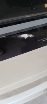

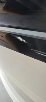

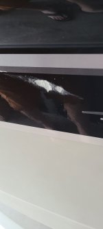

Ran into the ramp (not in the best shape) when a gust of wind picked up and i hit pretty hard. What is the best way to patch/seal this? Is their colored type fillers? Thanks for any input!! 2004 Sea Ray 185 Sport
Contact Sea Ray, get the Gel Cote number from them. Then contact Spectrum, a sponsor of our forum, and they will get you the correct mix, tho it may vary because of sun fading after 18 yrs.

Second option is to buy a gel coat repair kit (see below) and match the color as best you can. No matter what you do, you'll need to fiddle a bit because, as @zool noted, your color will have faded from what it was originally.
I've used the Evercoat kit and it's not hard to get very close to the current color.
