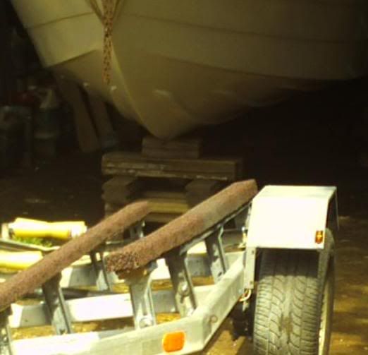

cabin logs work great! ;) only supporting the boat at the moment but same concept.
