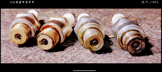

120 hp force missing on 1 and 3.
Very clean plugs. I pulled the #1 and #3 wires off while running, and no change.
They have sparked just from boot to plug. Swapped #1 and #2 coil. To see if the coils was doing its job.
I sprayed starting fluid around the block while idling.
It tries to die when I sprayed under or behind the starter.

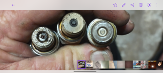

I'm going to see if I can add pics of plugs in order from left to right.
What's the likeness of sucking air from the crack block or gasket versus the intake gasket?
I could not find anywhere lower that effected the motor.
Sometimes when running faster, it might hit on #1 or #3 bc it takes off for a brief moment.
How do I confirm what I think I already know?
Take it easy on me. I'm already filling pretty bet up about it. I just sunk a lot of extra $ and time into this motor. Unfortunately I wasn't the one who took pics.Im not sure where #4 is and I'm sure the other pic is from right to left.

Do Plugs look water washed ?

The plugs that are so clean that they look new are out of cylinders that are not firing.
