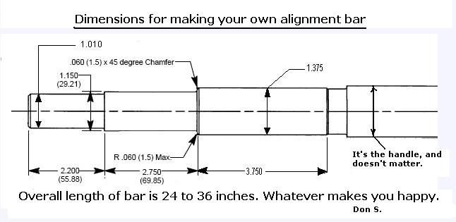

If you have access to a lathe, you can make your own alignment tool. I made mine with this.
