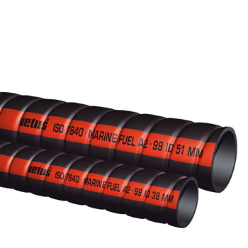

Yes, even in the UK, they sell the same products by Moeller Marine that we buy here, as well as other brands. This Vetus brand hose is a common UK fill hose:
Vetus Fuel filling hose is made of NBR rubber with spiralled steel inlay. Suitable for both petrol and diesel fuels. Meets the requirements of SAE J 1527 and ISO 7840-MARINE FUEL A2. Extremely flexible. Available in coils of 20 m
FIY...SAE J 1527 and ISO 7840-MARINE FUEL A2 are the same specs that Coast Guard approved hose must match.
