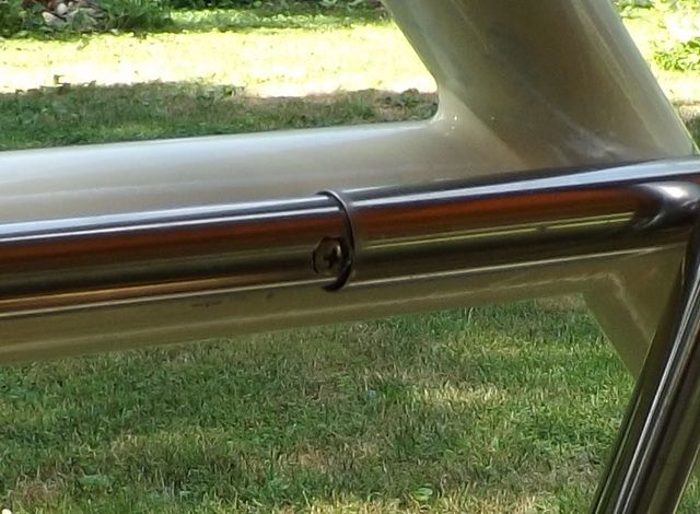

Hi Iggy. You can use a readily available larger size stainless steel tube to re-join bows if you find it necessary to cut them. In the picture below you can see a close-up crop of a larger picture I took of the bimini top structure that I built from scratch. The picture shows the point where I used 1" stainless tube to extend a horizontal 7/8" stainless strut secured to my tower. The fit will be slightly sloppy, so I'd recommend that you use a joiner that's at least a foot long so that any misalignment will not show. - Grandad
