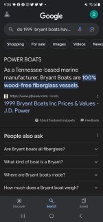

There is no wood on bryant boats .
But I will look for some epoxy to use to fill in the hole , thank you

It's a 100% fiberglass boat . I don't see any issues with the fiberglass. Though I might not know what to look for . I do think the black.flakes that I find In my engin bay come from the pipe that drains Into there
That is a rare all glass boat....I know newer boats have gone all glass but did not realize there were older ones. This will make those blisters much easier to repair, replacing wood structure really sucks !!!

Ah, didn’t know that it was all glass. Good to know. Yeah the blisters will be an easier fix, but as suggested, bottom paint is a good idea.
