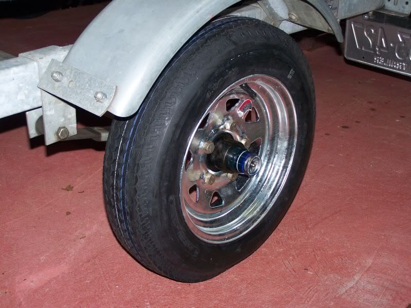

I didn't have a blow out, but was just one good pothole from it happening:
One of the tires on the well-used trailer I bought last season had a really slow leak so I decided I'm finally breaking down and buying a new one, then making that one a spare. I take it off and aside from a few small dry cracks in the tread (that I hadn't ever noticed till now) it still looks OK for a spare.
So I mount the old tire on the spare carrier with the dry cracks up and a little while later it starts to rain. Next time I look at it, the tread looks white and on closer inspection, there are tiny air bubbles coming up through the tread!! Mind you, this tire is only losing a couple of pounds of pressure a week so I had figured it was the valve stem. Now planning on a new tire for the spare too!
Just because it looks OK, doesn't mean it is. The sun and ozone down here in Texas really take a toll on tires, especially if you don't keep 'em covered. I'm also planning to pull the OEM spare off my truck and replace it now since it's at least a 2000 model. Why take chances, when it's so inexpensive to replace? (At least compared to what it could cost you if it blows out).
