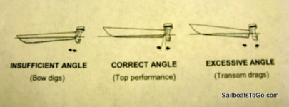

The issue I've noticed is the bow doesn't really rise/lift on plane. It gets up on plane and sits the bow down. Kinda plows? Going off the spray it looks to be riding with half the hull still in the water? The spray(wake or whatever its called) is just ahead of the console. Im used to previous boats riding just behind the seats. And it feel like its holding the engine back. And thats trimmed as far as the trim up will go (not sure if it hits a limit or if the trim can't overcome the engine pushing down against it) Throws a decent rooster tail on plane.

As for the lack of bow rise and plowing. I will assume the motor has power trim. While trimming the motor in(down) will reduce Bow Rise while getting up on plane, it will also cause Plowing at speed cause the motor is leveraging the Bow down. Trimming out(up) will allow the bow to rise while on plane.
