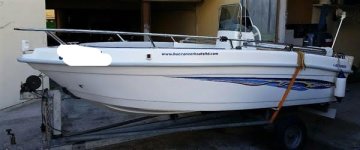

I understand but on the plate of the boat max rating is 32.5 how should i change for a bigger motor ? 😐
53,304
Max Rating on plate is 32.5....
Its exactly the same like this one
In Malta my country this is called buccaneer boats sorry for the confusion
the issue is the boat in the picture has a 40hp motor on it according to the facebook listing.
I agree with others. 25hp is not enough motor on that boat
you may be able to get a much lower pitch prop to get you out of the hole, however that boat needs much more motor than 25hp.

This is my actual boat i put that picture because its similar to mine and its in the water

I can't see much of your boat from the picture, but I can tell you from what I see that boat is underpowered with a 25HP. I'm assuming that your boat without the 6HP on the back, and three adults in it, will have a hard time planing; and it shouldn't.

I am wondering if we do not somehow have a misunderstanding between imperial and metric measures???? I can't imagine having an 80kG rating (approx 176lbs) for a 32.6HP engine.
I tried to go onto the website on the side of the boat, www.buccaneerboatsltd.com and it appears not to exist any longer. Again I will say that it is a good looking boat, but I maintain that it should have a larger motor hanging on the back ... at least a 35hp, if not a 40-60hp.
