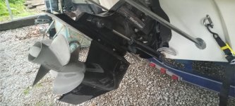

Once it sits down it goes up to 5.5rpm or so. Gains speed. I also noticed on my cylinders for the drive there is a limiter that doesn't alow the drive to drop all the way. Would removing this making the drive drop more help me? Its about a 2" ring that I bolted to the end of one cylinder.

Without a picture, it almost sounds like you're referring to the sacrificial anode on the trim cylinder. I wouldn't remove that.
Any chance you can post a pic of the trim cylinder??
Actually your 100% right. That's what it is..
Plus I had 40g of gas in it. That's a **** ton of weight. Might just have to have people up front till it plains. But I feel like it should Rev more than 3k even unplanned to give it power to pick it up out of the water. But idk I'll post a pic. Like I said once it plains it picks up rpms and gains speed nicely. I can peg the throttle and it it doesn't get above 3k rpm, Once it plains I let back on the throttle because if I don't it just starts flying. Haha.

Some picks of the drive.

52,770
those are anodes to keep corrosion at bay.
My guess, with everyone sitting in back, you were too butt heavy for the boat to get out of the hole
