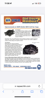

The line of products is called Echlin and they carry a lifetime warranty so the counter people are always very cool about exchanging it. I’ll try to find the article that talks about why Napa developed the special style crab cap to address the issues that plagues the other ones.

Fully aware of aftermarket parts suppliers in regards to marine applications
My comment wasn't indicative of NAPA's development of special parts in regard to oem manufacturer's creation of specific components regarding long term issues. The companies that created and have specific use relationships have already provided the work regarding replacement/maintenance parts. NAPA has simply "followed suit". This is evident in their retail price and apparently warranty
I'm curious as to your experience with warranting a cap/rotor with NAPA after normal installation/use after 6 months

It’s been super easy to get a free one each time. They don’t even bother looking at what’s wrong with it because they know it’s got a lifetime warranty. If they ask, I just tell them that the amount of corrosion was surprising.
The first link points to a distributor cap that has brass. The ones that I am buying look 100% to be aluminum.
