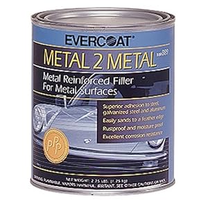

Evercoat makes an aluminum filler called metal 2 metal it is NOT 100% waterproof since it contains talc but once painted it is WP. I Sands and finishes very well.
Metal-2-Metal?
Aluminum filled body repair filler for metal surfaces. Has excellent corrosion resistance and superior adhesion to galvanized steel and aluminum. Will not sag. Best known as the "nearest thing to lead." Moisture proof. Rustproof. Easily sands to a fine featheredge. Metal-2-Metal? liquid reactor included
I'm just sayin...:D
