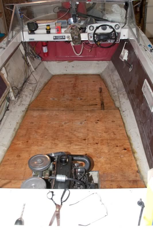

We put a new deck in my cousins 1969 Slickcraft this past fall. Thanks for that help.
Before the second coat, and carpet.
We used the Epoxy coating from Areo Marine, with two layers of woven mesh.
Now for my next question. The bottom of the boat is looking quite aged. We want to recoat it. What is our best option? This is a fresh water fishing boat, that is stored inside on the trailer. We are not trying to make a Trailer Queen, or restore it back to original. We are located in West Michigan.
