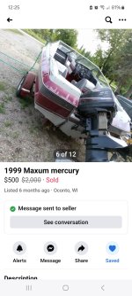

Yes clearly lol.... but I can not find out what kind it is. Based off the pictures and what others have told me..... without any identifying information......I can deduce that it is a possible mercury 2 stroke outboard that dates back to 2005 at least or later..... but that's not enough information for mechanics. Many of them are refusing to touch it without knowing what it is.

Look at the last pic with it on the boat. As i mentioned, it is an 85 hp Force not Mercury as the ad states. Probably same year as the boat. The pic with the spark plugs states US Marine poer. Google that to start your history lesson.

They dont make those motors any longer, sadly. Easy to work on basic motor. That said imo you sell or give it away for scrap and after you have decided to keep and repair the boat you find a running motor to replace it with. Parts are getting very hard to find.
