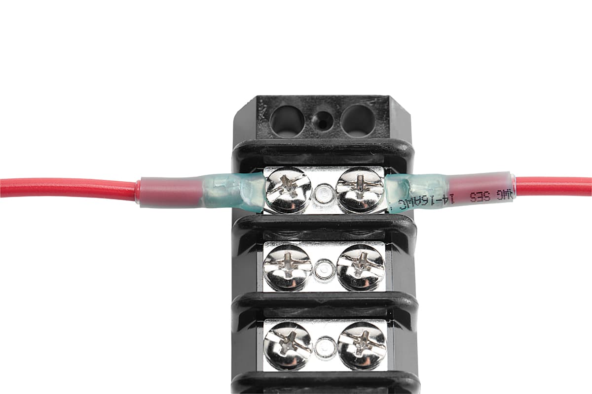

Put on the 2nd transom layer today. Got my kids so could've be in the boat to much. I did work on the motor though. Got the new powerhead on and now I'm working on putting the wires all together. I did run into an issue I need help on.... the control box has a connector piece for the electrical components that plugged into a piece on the old motor. The new motor piece does not match. I am thinking on snipping the wires from the old piece and switching it to the new powerhead. How do i properly splice the wires together? I take it twisting the wires together and electrical tape will not be sufficient lol. Can I solder the wires together or is there a better method?
kcassells
Oct 16, 2012
8,743
Any number of ways to do it properly. Solder, crimping {many types to use. Cover with shrink tube, done.
Marine grade wire is suggested and is copper strands coated or called "Tinned". Recommended.
