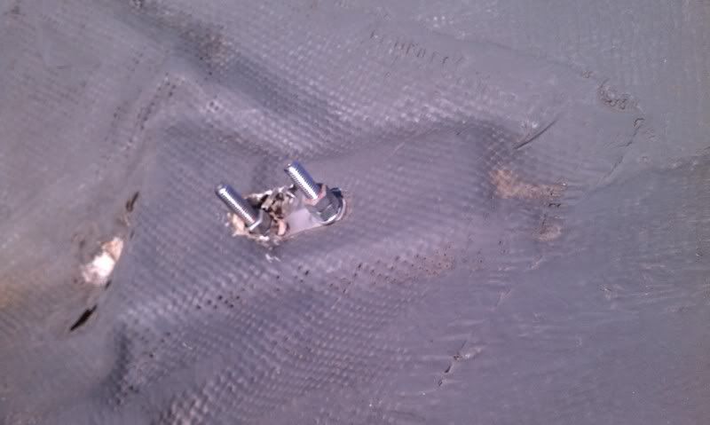

Took my family out today on the boat.. Had a fantastic day and things were great.. Finally after a nice day we get back to the ramp and go to put the boat back on the trailer and as im winching the boat onto the trailer the EYE on the boat pulled out I managed to get the boat on the trailer and secure it down and get home...
How do i Repair this problem, Theres no access to that part of the boat to resecure the eyelid back on.... Now the weird thing is it looks like there were no nuts on the back of it like it was just expoxyed in to begin with... Help me

you got it .. I take some pictures today and post..... The boats a 16 foot bayliner/trophy Center Console... 1988 year.. the floors and hull are solid.. I can believe this pulled out..

How did you manage to post your pictures upside down?
It looks as if the factory never installed the nuts on the boweye, at least you don' t have damage to the hull.
How about a picture of the interior of the bow area.

Yikes! Sounds like you have already gotten this project underway, but just in case it is helpful to you, here is a picture of what the inside of your bow eye support probably looks like:
Mine is obviously damaged, just not to the extent that you experienced! My plan is to remake the fiberglass support and add a large SS backing plate. Can't believe the factory would build like that!
Good luck and let's see some after pics!
