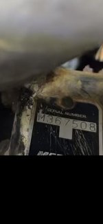

Here is one of the serial numbers. This motor is marked as manufactured in 2005 on the ecu board. The second one is missing the tag. It’s labeled as manufactured 2002 on the ecu. Any other way to get the serial number? I actually need it for my insurance policy. The only noticeable difference between the 2 is that air actuated drain system that I’m Removing. I ordered a copy of service manual 31 so hopefully I won’t need to spend so much time asking questions here. I do appreciate the help though.

You should be good to replace like the other one. Part number 862776A01
