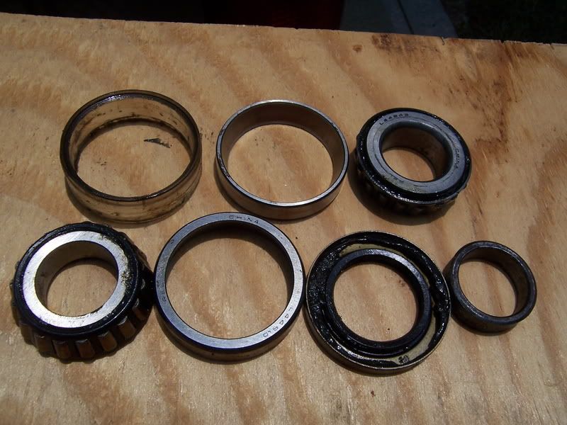

Went and took one hub out and found out it was an old bearing protector that broke. It is made out of plastic!!! Here is a photo of it. It is the first item from left to right on the top row.
I have a few questions but will make a separate post for it. I had no time to do the other hub. I will do it tomorrow but I expect it to be the same.
