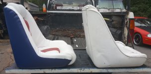

One seat is done. The other should be a snap because the patterns are made, and most of the parts are marked out, if not cut and sewn already.
I reupholstered the seats in my truck five years ago with good success, but I have to say that covering these glorified plastic buckets is more difficult. Overall I am satisfied with how it turned out, and it is pretty comfortable to sit in.
I like the fact that I saved around $500 by not buying new ones. That's substantial to me. Staying in my budget while building an almost-like-new boat.
Staying with the American flag motif, too.
