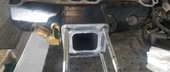

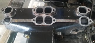

Gaskets & such, why is the top of the piston so clean?20210623_080938.jpg20210623_080944.jpg20210623_081643.jpg

appears to be witness marks of some seepage past the head gasket at the cooling ports
you mentioned the head bolts did not seem to be as tight as you'd expect, perhaps this was the source of water intrusion

I dont think there was any water intrusion into the cylinder, I think the piston was washed with fuel when running the 75 miles back to the harbor. No compression at this time. Heads are at the machine shop for new parts as needed and getting refreshed.
We made a plate and did a leak down test on all the cylinders and #3 was not the worst, not great numbers but OK for a couple more hours. Thinking rebuild replace in the next 200 hours, that will depend on future leak down/compression test. Also attached pic of the compression test before removing heads. All in all I think I got off very lucky. lessons learned...20210623_192141.jpg20210623_192147.jpg20210623_192504.jpg20210623_192805.jpg
