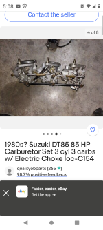

080AF7D8-8FE1-4855-814F-083C2C3D3772.jpegthis is where it’s coming from. Any idea what screw or what to do to stop it.

I wiped it off and observant coming out of that hole when the engine is running it is not burned

looks to me that hole is above the fuel bowl level, so fuel should not be that high.
might check the float and needle and seat to see why it is over filling

Is that the bottom carb? Hard to tell from picture. What happens if you plug it while running? If it runs good time to MacGyver something.
Will try it tomorrow and let you guys know. It looks threaded on the inside.
Ok so I covered it, it still has a leak at the bottom of the carb. Any idea what it is? Stuck float or needle? Any good articles or step by steps on how to clean this?

I’m a complete noob when it comes to working on engines. How would I do this
