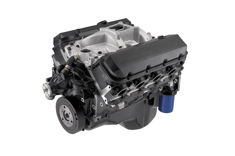

I have an older 25' cuddy which has the original 330hp 454 from 1992. She still gets up and goes and seems to have decent compression with minimal oil consumption but I was considering pulling the motor this winter and stroking it to 496 and throwing some better heads on it than the current peanut ports. I feel like putting work into a 30 year old cast iron block from a boat bought from Florida may result in some corrosion and pitting in the water jackets.
Then I started looking at crate motors. I have a GM employee discount and this 502 caught my eye:

I notice the NOT INTENDED FOR MARINE USE note so I started doing a little poking around the internet and I see this is a pretty common question.
The first thing I notice people say is that you need a USCG approved starter, alternator, carburator and ignition. This engine is void of all of those components so I would either be reusing my current starter, alternator, carburator and Thunderbolt IV ignition or simply buying new USCG components for peace of mind.
The second thing I noticed is that people say is you need stainless head gaskets and brass core plugs. I only use my boat in a fresh water lake. Regardless, if this engine does not already have brass plugs and stainless head gaskets those would be easy enough to swap out upon receiving the crate engine if I really wanted to.
The third thing I notice that people say is that the cam would need a lobe separation of 112 or more. The cam in this engine has a cam with 112 degrees of lobe separation.
Is there anything that I am missing? What are your opinions of this particular engine?
