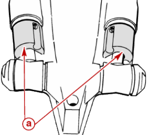

Wiki explanation:
A galvanic anode is the main component of a galvanic cathodic protection (CP) system used to protect buried or submerged metal structures from corrosion.
They are made from a metal alloy with a more "active" voltage (more negative electrochemical potential) than the metal of the structure. The difference in potential between the two metals means that the galvanic anode corrodes, so that the anode material is consumed in preference to the structure.
The loss (or sacrifice) of the anode material gives rise to the alternative name of sacrificial anode.
There will be several anodes on most outdrives, here are a couple.

So those are all the "aluminum" looking parts on the outdrive? I think I know what your referring to, the descriptions states there multiples ones all over the outdrive? How do they wear out, how can you check if their no good? Is it just a visual thing?
Thanks again this is great info from everyone. This is exactly the kinds of things I was looking for so I know what to spot when searching for a boat. Hopefully everyone will keep chiming in as they have been, that way I can compile a list with all this stuff when I go to look at a boat and will have a better understanding of the flaws to spot. As I'm only 26 I hope I can gain much knowledge over the years and really benefit when time comes for repairs or upkeep.
