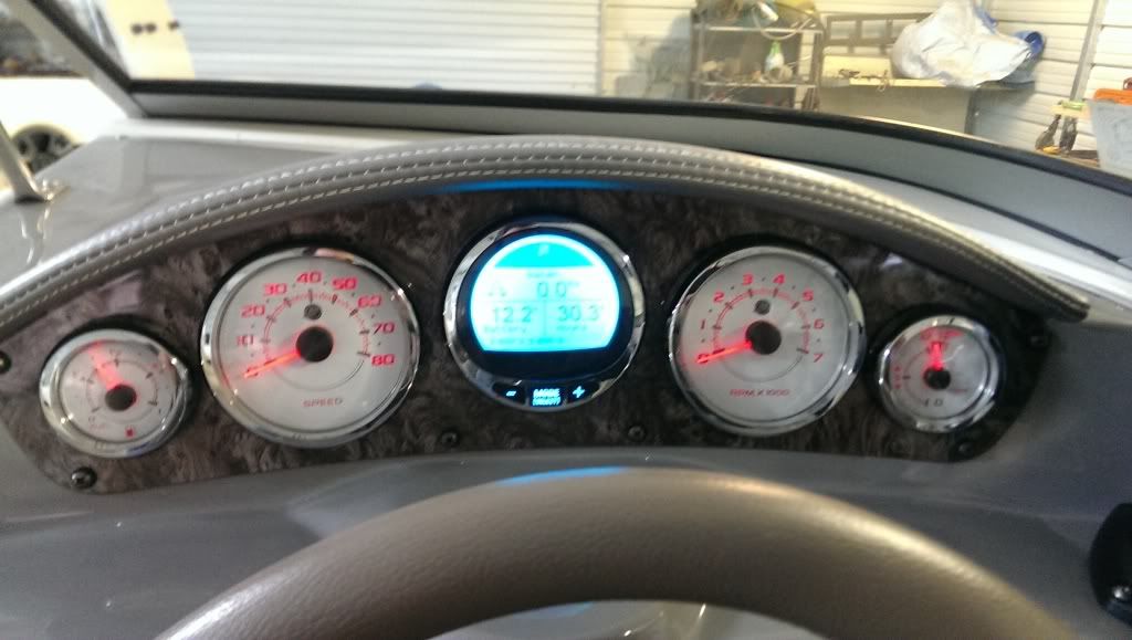

A MercMonitor with Level 1 feature like the NMEA gateway is only few $ more than the gateway alone and can give you all the info you're looking on it's screen.
Here's my setup:
http://i1028.photobucket.com/albums/y343/dan02gt/IMAG0280.jpg
http://i1028.photobucket.com/albums/y343/dan02gt/IMAG0304.jpg
I've never bothered hooking it to a chartplotter because the MercMonitor gives me all the info I need. The analog gauges are actually Systemlink gauges the network to the MercMonitor.
