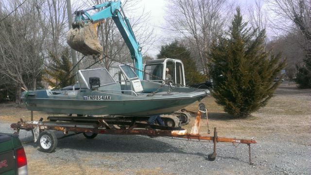

Had an Accident while swapping trailers. Was using a 5000lb rated strap to hoist the boat it broke.
When it broke the weight shifted all onto the back corner, bent the crap out of everything. I had it strapped so that it wouldn't possibly fall off of the excavator, and probably the only thing that stopped from being crushed was the new transom and the Stainless steel backer plates.
Anyways tell me what you all think did I warp the hull? Can I fix it?

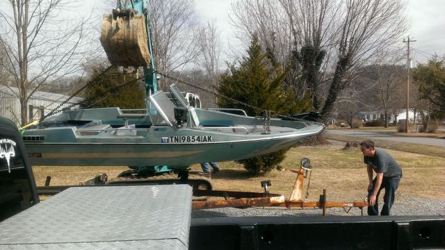

Was going something like this playing trailer swaps didn't want to use chains on the SS because I didn't want to mar the paint job.

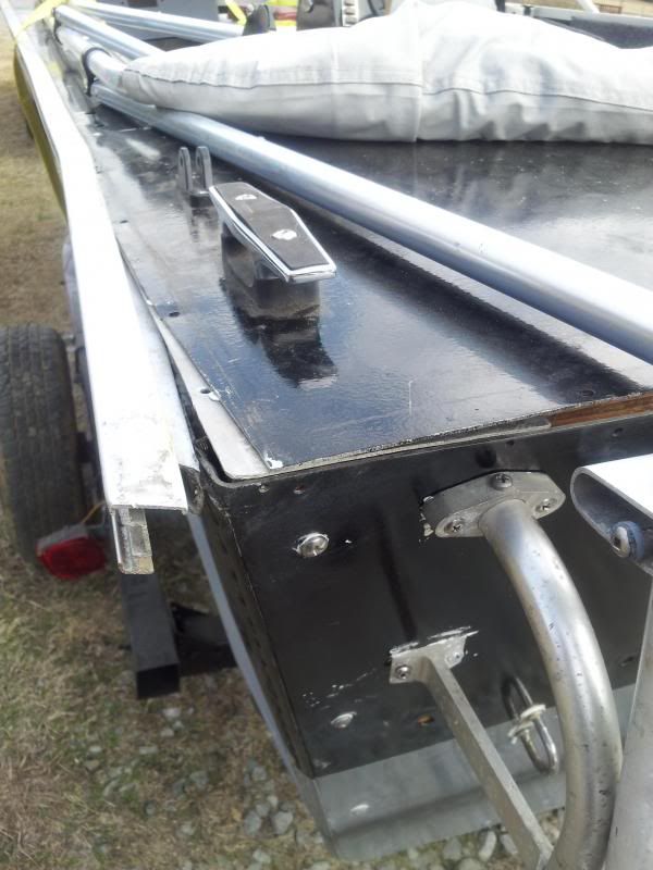

I think we need some lower-mag images to determine whether or not there's any larger-scale damage.
to me, it seems local to the port-aft corner.
it may need some persuasion...and possibly braces...to get it back in place.
did any of the transom bolts shear/distort?

AW Sig. I blame the glasser. I don't like the looks of the port corner. It seems the hull and gunnel are shifted apart by an inch or more. And are some of the screws holding the splashwell to the transom wood sheared? Have you looked under the S/W yet? Maybe the S/W took the brunt of the hit.

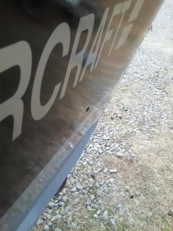

Underneath she seems ok, on the side there is a very slight concave to it most of the damage is centered around the port aft corner you are correct.
Underneath she is ok she didn't hit anything but the strap.
None of the transom bolts sheared or distorted.
Yes it was horrifying since I've been a grown man, I've cried only once the day they put my granddad in the ground.
I almost cried when I saw it.
Actually Ga I got luck with the splashwell it hadn't been screwed to the transom yet I was going to do it when I mounted the fuel tank so I would have room to fudge a little if I needed. The aluminum trim piece on the transom had not yet been fastened either. I am kind of hoping that the splaswell took the brunt of the hit and warped it a bit that I can use a strap to pull it back in place, and rerivet it.
Again I had the strap secured to the transom hook, which has the 1/4 SS backer pad on it. It didn't even dent the plywood in the transom.

From what little I can see in the pics, it looks some minor contact damage but what your worried about is induced damage to the hull. I don't see how it could have hit on a stern corner (the strongest area) and caused much if any real damage by the way of warping the hull or ruining the boat. The transom would have done it's job and absorbed most of the impact. Worst thing I can see is the transom cover is tweaked.

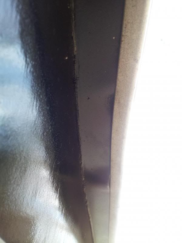

I was concerned when I saw the S/W flange was separated, but not fastened could have allowed it to flex. And looking at her again, it looks like the port gunnel cover may have shifted to the right. Hoping that's all it is. Are there any wrinkles in the gunnel near the kink in the rub rail channel? In the third pic in post #1, is that kink in the rub rail channel?

Yes Ga, that kink is in the rubrail channel.
There are no wrinkles or creases anywhere in the hull.
No wrinkles or creases anywhere in the gunnel either.
The rivets holding the splashwell into place broke and it appears to have ripped the bolts holding the rubrail channell out as well.
There was a big dent in the side of the hull, however when I got the tension off the strap I smacked it with my palm and it all popped back into place.

Stitching failed and on a brand new strap. I had chains I could have used but didn't want to risk the paint I guess I should have went with the chains.
I think next time I am not going to try to lift the whole boat (not what I wanted to do anyways). Going to use two chains on the transom hooks lift back end up first and move it onto the trailer right next to the old trailer, unhook and hook to the bow eye rehook and move the front end over that way at all times the hull is supported from the bottom.
I wanted to it this way from the start, the excavator operator wanted to build a cradle out of straps.
