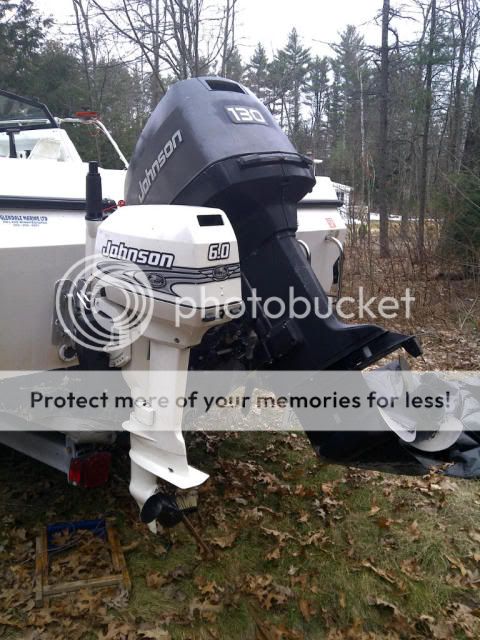

Title pretty much says it all. I spend hours trolling on the lakes, and would like to be able to have my trolling motor charge my batteries so i can keep using my electronics. Can my motor do this? Here is a picture of it, im actaully not at home now for another week and cant give the exact model number.

not looking good but....."early 2000's" is a bit vague to verify much of anything. model #?
I dont have it with me unfortunately....

They did build a bat charging kit for a 2000 6-8 hp part # 176960, but it's now NLA.
