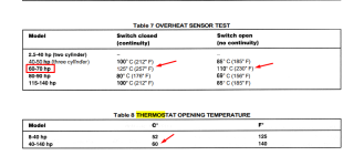

I know it is strange, but that is chart (in picture), for my Tohatsu 2-stroke. So, you say, that my outbard is overheating (closing the sensor = trigger alarm).

That table is very strange, but just for your motor. The rest of the entries looked about what you would expect.

The Table is from owners manual, and I checked on other languages, it is same. Also checked in the Service manual for all 2-strokes 3 cylinder (60-70hp) and the temps are unreal.
