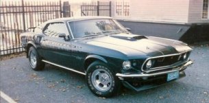

lol I'm old enough to remember when those cars were NEW. In 1968,1969, 1970. Best years for muscle cars. You could walk into a Ford dealer and buy a Mach 1 for less than 5 grand and a Boss 302 for about 4700.

i was only 9 in 69 if i had know Id would have loved to buy one then lol to think you could have done that and if keep them till now I got my 69 fast back in 78

I was 14 then and my best friend's dad was the shop manager at the local Ford dealer. At the time Ford and Chevrolet were right across the street from each other. During the gas shortage circa 1974 (not shortage but OPEC's extortion) I saw a 1967 Corvette at the Chevy dealer, sitting on the used car lot, it had a 427, 3 deuces, outside exhaust and it was a convertible. $2500. And it sat there for a while!
