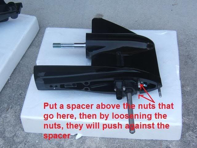

As mentioned, make sure you have all the nuts / bolts off. One trick is to put a spacer of some sort above the nuts and as you turn them to loosen and take them off, they will push on the top of the upper. Easy to do, hard to describe! :confused:
Fishermark
Oct 19, 2003
5,627
Re: Can't get lower unit loose Alpha 1 stern drive
Here's a pic to show what I am talking about:

its 5 nuts and 2 bolts holding the thing together... do you have 5 and 2 in front of you?

Love the spacer idea, had a real hard time getting my units to separate. Once I got a tiny separation at the leading edge, was able to work it with a thin blade, lots of WD40. Once you finally get some movement it should come apart fairly soon after. My problem was probably 2 fold: I had a lot of corrosion along the studs, should have worked on that, picked it clean, and secondly had the o-ring jammed up into the other shaft. Good luck, just keep working it.
