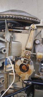

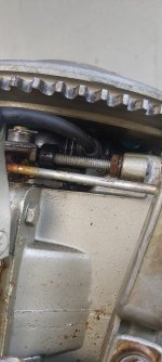

It was off the bumper, but still seems to be doing the same thing but now it dies right away also. It fires and runs for 2sec and dies. The bump stop lookes to be fully extended should it be screwed in more maybe?

Do not start adjusting anything with the ---" lets see what happens "--- approach.----- If maximum timing advance is not correct you can do serious damage.-----Best to clean the carburetors first.----When you remove carburetor bowl drain plugs , do you see a green film on the end ?
