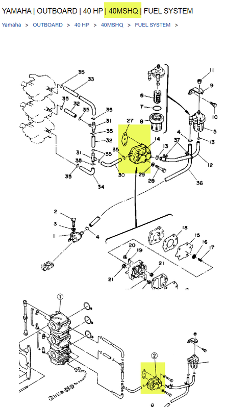

Carburetor question on restoration I’m working on 1992 40 hp MSHQ Yamaha
Douglasdzaster
Sep 11, 2020
315
That is not what the parts catalog or the service manual shows. What be we missing?
In the picture the fuel filter is missing. Was that way when I got it. Since then I’ve ins the filter and it looks like your pic. Also the oiler had been disconnected and tank removed. You can see the VRO pump sitting under the fuel pump.
Sea Rider
Sep 20, 2008
12,345
I'm plainly in agreement that fuel pump it's not attached to the lower carb, pics in post 16 shows it all. Must have clicked by mistake the Tohatsu 40 HP spare parts page which lives side of the Yam's 40 page. Let the one who has never had a senior moment to cast the first brick.....
