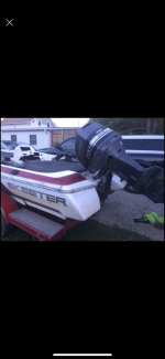

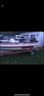

No worries. One piece at a time, speaking of one more piece. Picked up its motor today. 200hp two stroke V6

Did I miss what size boat she is? Nothing like a good glasser for a donar boat.

Nice, the 200 HP should should be a nice fit
