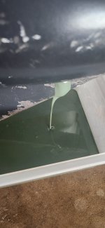

Here is a picture of the gear oil from the OD. It is a blueish-green color.

If you get brown crud out of the ujoints that’s not normal and they’ve internally rusted and must be replaced. If they fail with the boat up on plane it could tear up the transom mount & let water in the boat. Risky & potentially dangerous.

I think you do have water in the gear oil….
