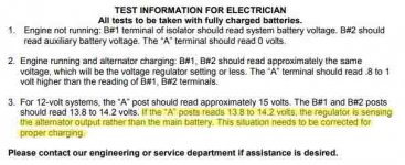

It makes sense. I just found on internet the manual on my diode isolator, and they say to cut the B+ wire and pass another wire to the isolator.
I'm surprised that my boat didn't come already equipped like that from Chaparral...

Thanks for the info.
Yes the 'excite' is internal and I won't modify the alternator.
The Argo isolator 'FET' semiconductor seems to be a good solution, with a maximum of 0.1V drop at high current, and less drop at low charging rate.
Either that or the ACR, but both seem to solve my problem.
You say that you cannot install it on your boat because there is no 'excite' output, but I see one small terminal named 'energize' won't that be the trigger signal for your alternator? just taking a guess...
In my diode isolator manual, it says that if the voltage is too low at the battery, the alternator needs to be modified for external sensing. This is the solution they offer.
The problem with a modified alternator is if it breaks, it is not possible to just order a new one, this specific one needs to be repaired with the delays.
