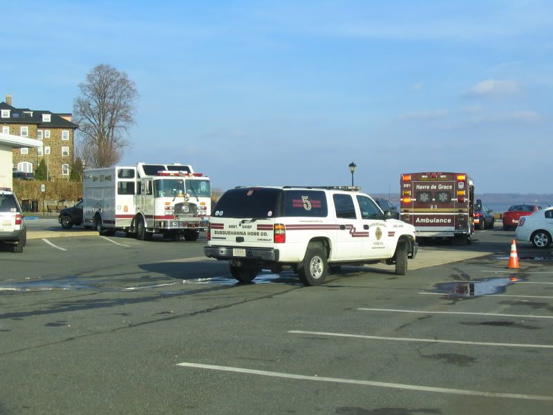

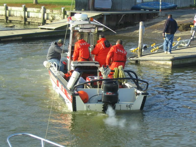

Here's a shot of them leaving my marina, and apparatus waiting at the scene:
