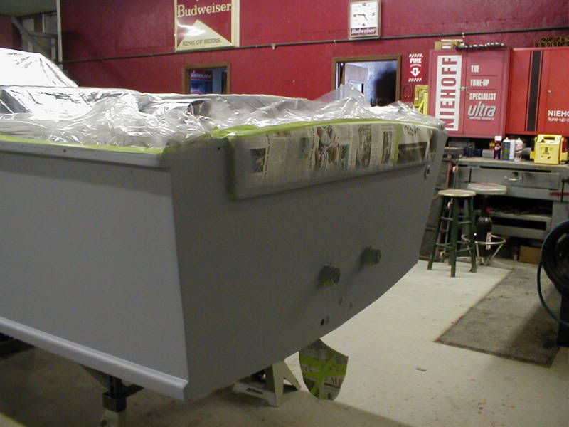

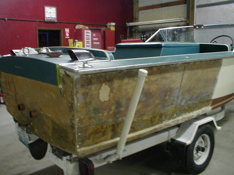

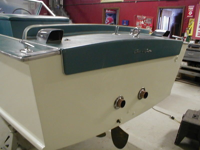

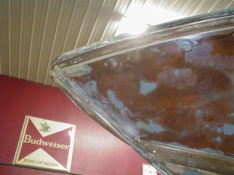

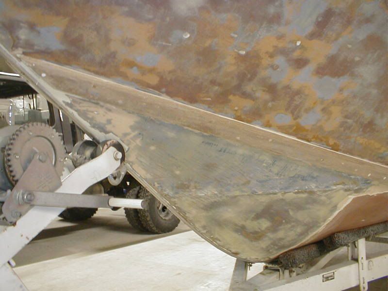

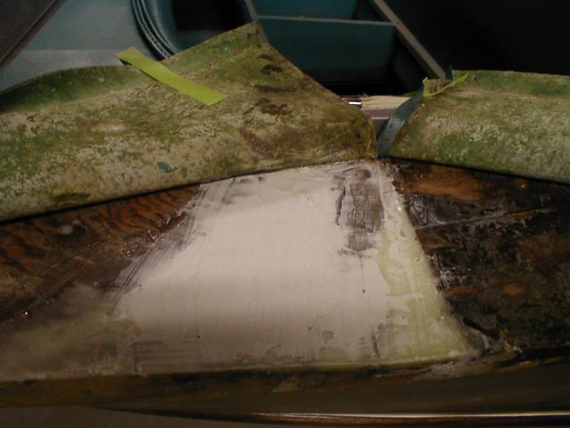

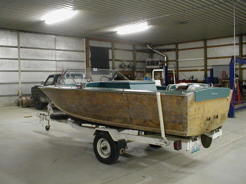

I didn't have any real wood boat skills when I started but I aquired some along the way. If you can't stand stripping paint, sanding, sealing, sanding, fixing rot, sanding, priming, sanding all by hand on your back , well you get the idea. Got several hundred hours in it. Luckily the interior was in good shape. It turned out decent, get alot of interest in it whenever I take it to the lake. Here's some pictures I took through the process:
http://i36.photobucket.com/albums/e10/KinkA-1/PC100003.jpg
http://i36.photobucket.com/albums/e10/KinkA-1/PC210003.jpg
http://i36.photobucket.com/albums/e10/KinkA-1/P1180008.jpg
http://i36.photobucket.com/albums/e10/KinkA-1/P1180010.jpg
http://i36.photobucket.com/albums/e10/KinkA-1/P1010005.jpg
http://i36.photobucket.com/albums/e10/KinkA-1/P2070003.jpg
http://i36.photobucket.com/albums/e10/KinkA-1/P1010003.jpg
http://i36.photobucket.com/albums/e10/KinkA-1/P1010004.jpg
350 Chevy small block 250hp. Duel through hull water muffeled exhaust. Sounds like a muscle car on water. Direct drive forward and reverse, no real neutral. They don't go backwards worth a darn.:D

Does that rascal actually touch the water at wot?
Most of those straight drive trannys have a panetary gear with a forward band that locks everything up for direct drive forward and a reverse band that
locks up the planetary creating reverse.both bands released is neutral.
Sometimes if a band is tight you may get some thrust in neutral.
The transmission very loosely resembles early automatic car transmissions.
