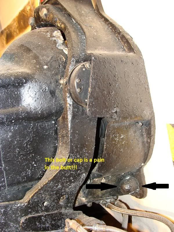

Transom Assembly Removal Preparation and question?
Hey guys, I'm getting ready to remove the transom assembly and transom plate, bell housing, etc...
These sacrificial nuts, or caps, or whatever they are won't budge, and I'm just thinking about cutting them off. I plan on going back together with all new hardware, so does anyone see a problem with just breaking out the grinder with a cut-off wheel???
Here's a picture... It's an older picture, but just for illustration purposes. I've labeled the offending part...

Ok, I was hoping I'd have someone chime in, but I'm headed out to remove the transom assembly. Probably having to cut those bolts off, but I'm using new hardware in the re-build, so oh well... Videos later...

I got most of the transom assembly removed, or at least dis-assembled tonight. It was really a mess. I'm so stoked I picked up the newer used transom assembly a couple weeks ago. It was definitely worth the $150.00. I should have the rest of it off soon, maybe tomorrow, and then I'll concentrate on doing all the glass work for the hull and build the new swim platform. I just didn't see the point in trying to finish "around" the shot transom assembly...
Oh yeah, more good news, all the ply around the Transom opening is solid as a rock. I figured as much, because last year when I installed the trim tabs, all the shavings were dry and light in color, so I'm very pleased about the Transom.
Here's a short video showing the extent of the corrosion.

I am sorry I did not see this earlier. Those anodes do not move. You take everything off from the inside.

No worries Jay...
I actually got the Starboard one off with some vise grips and a small sledgehammer... LOL... It was threaded on the inside. Hoping I can get the other one off without damaging the threads once I get it all out of the boat. The bolts look to be in great shape, don't think they are brass, but whatever they are, they are corrosion free. The only thing holding me back now are the remaining steering components on the transom assembly. I want to make sure I don't damage anything. everything looks to be in good working order back there, and I think I may just need a new helm pump. That would save me a small fortune! Also going to have to figure out the water inlet tube on the new bell housing versus the old, as they enter through the transom plate and point in different directions once they get in there. I'll get it all figured out, I have plenty of time, and I can only work on it a couple hours at a time, so slow and steady wins the race...

On the anode bolts, They must make diffrent styles. On mine, the anodes unscrew from the anode bolt on the outside but the nut that holds the bolt on is in the inner transom.
You got a great deal on the new assemble. good job.

In reference to the anode bolts, mine were just as you described... The anodes unscrewed from the outside, but that bolt has a flange on it and then there is a nut and washer on the inside of the transom plate that snugs everything up and is what ultimately has to come off prior to removal.
