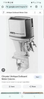

Hello, I'm totally new to boating. I am restoring a 60's speed boat. It origanilly had an outboard motor which from google research , looks like its a chrysler 105 .
From photos attached , can someone please confirm if it's a 105? And can you please suggest me a good site that might give me a good chance to find one for sale?
1st photo is of the actual boat in 1969. Motor was lost.

The Chrysler conqueror 105 came with a 105 outboard. The Chrysler 105 OB actually was only about 90HP at the prop. So if you have a Conqueror 105 then you need a 105 OB
Can find some OB on a few facebook pages Chrysler Boats and Marine, Chrysler the best outboard ever and a few others

I noticed , the short bolt word is on the far side of the motor. And this is the closest photo I can find. Are they rare in US?

Thats very helpfull. Thanks. I will look for any signs / prints to see if its a conqueror. The boat is 4.5mts long
