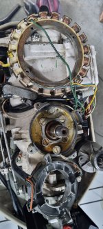

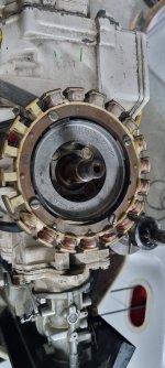

This is what I found. Does everything look right?
Joe22
Jan 30, 2023
21

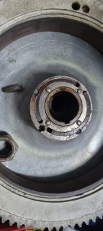

Going by your last comment I can see everything that is supposed to be there so everything looks ok to me I think
Joe22
Jan 30, 2023
21
Hi Nordin, was just reading in another article you commented on about using a screwdriver to see how strong the magnets are. The stator magnets are very strong, the one for the trigger not so much which is what could be causing me these issues. If there way to fix this or is that a whole flywheel replacement?

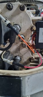

Next problem....... I just installed the new CDi and from the red wire to ground I'm getting 31V, from the orange to ground I'm getting 0.15V.... what's next?
Joe22
Jan 30, 2023
21
Sorry, 1.5V from #1 orange cylinder. Is this normal for the way it fires up?
Nordin
Jun 12, 2010
2,698
0,5 VDC or higher from triggers.
180 VDC or more from stator to CDI box (blue-yellow) connected.
Orange and red are output to each coil.
No spec. of output from CDI box to coil.

Nordin
Jun 12, 2010
2,698
Joe I can not say if the magnetic field is strong enough but as the trigger magnet is smaller and it suppose to generate a low voltage to the CDI box to dump the capacitor voltage, it would not be so strong.
I would suggest you to take a closer look at the trigger ring.
As the triggers purpose are to give singal to the CDI box to dump the voltage in the capacitors to the ignition coils and to the right one and in right time there could be something wrong with it.
Bad insulation or some rubbing to the power head or some problem e
with the winding in the coils.
Have you checked the resistance in the trigger coils?
Should be 48-50 Ohm and also check resistance to ground.
Should be infinity.
Joe22
Jan 30, 2023
21
Sorry I didn't get a notification.
48.1 and 49 and all 4 infinity to ground
