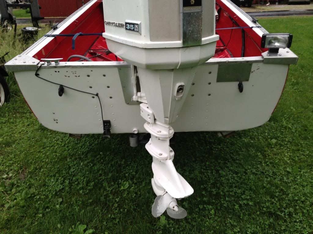

Just picked up a 1972 MirroCraft, 14 ft x 63 in aluminum boat. The only gauge on it is a volts gauge. The prop on it is chipped in several spots and has a hair line crack starting on a fin to the base. The prop size is 10 1/4 x 11. I found a 10 3/8 x 12 1/2 off of a Chrysler 35 horse with same amount of splines. Will this work? How will it effect take off, top end or handling? I use it to cruise around a small lake I live on, usually just myself and a dog, but from time to time I pull my 13 year old Grand daughter on a tube. I'm not looking to race around the lake but am wondering if this be would safe.

Got any pics of the rig? I am a sucker for those years of Chrysler motors... :)

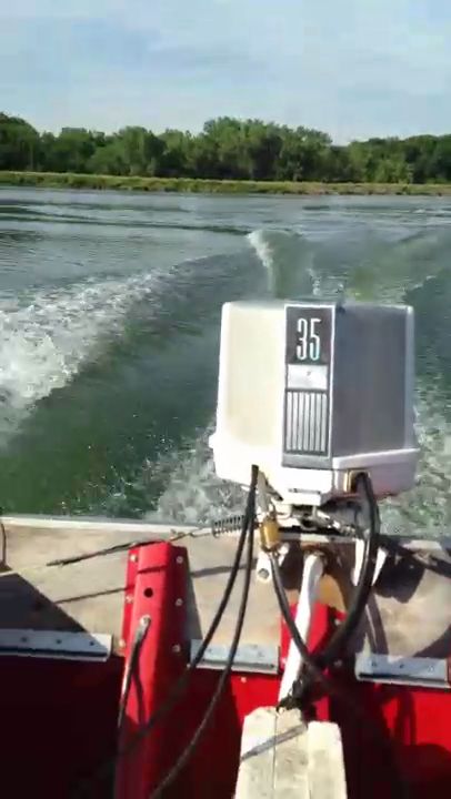

The motor sounds good at wot and doesn't seem to struggle. With a 110 lb girl on the tube and me at 200 plus a 150 lb passenger it does feel to struggle if they put their feet down or sit in it. Just me and my 70 lb lab in it runs and sounds good. I've been around boats all my life and watched my Dad and Uncle go through props looking for that perfect one. Repairing it may be the way to go. Thank you both. Here's a video that may help.

Nice rig tmb. Sounds like that is the perfect prop too, good luck and happy boating!
