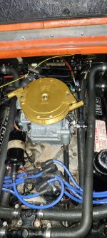

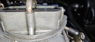

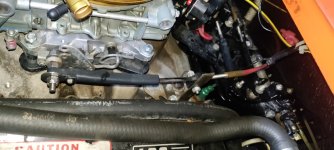

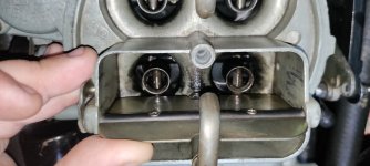

Apparently I already had the idle screw backed fully off.
Guess I'll have to try it and see how it does. Doesn't act like it has a vacuum leak so short of leaky throttle plates I have no idea. There isn't a functional fast idle cam since this is a marine carb. All of that was cleaned up when I rebuilt said carb last off-season. It does seem to be hitting a hard stop, not sludge. If memory serves there are factory holes in the throttle plates.
Maybe the secondaries are kicking in somehow??? The linkage won't let the plates move a whole lot at idle but maybe it's just enough?
FWIW the current idle mix screws are at 2 turns out on the port side, 1 3/4 turns on the starboard side.
Edit: I was running with the flame arrestor installed during yesterday's tests. See extra picture.
