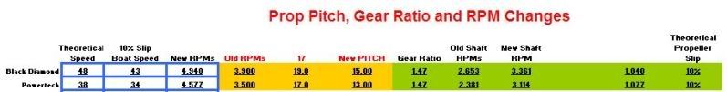

okay, i have tested two props today and tried to get some data.
first I have a Tahoe 228, 22' 8". Full gas 48 gal; full water 22 gal; crew wife, two kids, and myself 435 lbs; mercruiser 5.0 MPI 260 HP 4600-5000 rpm; Alpha 1 drive 1.47:1 ratio.
Test area : Lake Powell Alt, 3600 ft
test 1
14 1/2 x 19 three blade Aluminium probably a quicksilver black diamond.
ave time to plane~14.3 sec, WOT 3900 rpm at ~35 mph, 27.5 mph @ 3000 rpm.
test 2
14.25 x 17 4 blade PowerTech SS
ave time to plane ~12.5 sec, WOT 3500 rpm at ~32 mph, 30 mph @ 3000
Don't quite know how to interpret the data :confused:
Is this data decent for my boat? Also, if not, what do you recommend? I mainly cruise around so I am not necessarily interested in top end speed. Am I "hurting" my engine by not having a prop that can reach the WOT RPM?

Joe,yes you are hurting your engine with RPM that low. At the altitude you are running at you are trying to use props with too much pitch.You need to buy another black diamond with a 15" pitch and your RPM will be right at the max of 5,000 RPM.

Thanks for the response! It seems quite scary to drop down so much from what was OEM to a 15" pitch 3 blade or 13" 4 blade. Is this common or am I running a boat that is underpowered? Also, can you expand as to why running at a lower RPM it would hurt my engine? Thanks for your input again!

Joe, it is a lot scarier to run your motor with that much of a load on it at all times. Think of it like having a toyota car with large racing slicks on the front wheel drive and then only having 3rd gear for everything from takeoff to top speed and going up a 45 degree incline all the time. Can you imagine the load that is putting on your motor all the time. Mercury makes what they call a high altitude kit for boats that run at higher altitudes, what it does is change your outdrive gear ratio from your current 1.47:1 to a 2:1 gear ratio, and that is more like having your car be able to start and run in 2nd gear to take the load off the motor, there are other options but I need you to fill this form out so I have a better basis for my analysis for the carb.
I could discuss altitude and its effects on motors and the hanges everday that happen when thehumidity goes up but itprobably wouldn't mean anything to you anyway and it is too deep a subject to waste time on.
Iboats Boat and Motor Info
1. Year, make and model of boat
2. Length, width and base weight of boat, look for boat decal on back of boat
2a.What is the recommended HP for your boat
3. Number of people and gallons of gas normally on boat
4. What do you use the boat for
5. Is it a Deep Vee and if so how many degrees of deadrise
6. Year, make and model of motor
7. HP and gear ratio of motor IMPORTANT
If you don?t know the ratio, you need to pull the plugs out and put a piece of tape across the prop and the lower unit and then cut it between the prop and the housing and turn the motor until the tape lines up with each other, it is easier if two people do this, so one can watch the prop while the other counts the revolutions of the motor
8. Manufacturer?s recommended Wide Open Throttle (WOT) range
9. Anti-ventilation Plate height above keel of boat if it is an outboard in inches
10. Is it a bass boat or does it have a pad bottom
11. Does it have a hydrafoil, dolefin or trim tabs
12. Make, model, diameter, pitch and whether SS or aluminum prop
13. WOT RPM and speed from your current prop and how much gas and how many people were in the boat for the test data and is the speed by GPS. If you do not have a tach you can buy a Tiny Tach for $ 50
14. Are you at sea level or a higher elevation, give us the elevation in feet
15. Has your motor been tuned up lately and have you checked that the carburetor butterfly is opening all the way, checked compression, and looked at the plugs and checked spark, all of the foregoing could be the reason your prop is not attaining full RPM
16. How long has this prop been on the boat and why, at this time, do you think it is the wrong prop
17. Does the prop show any damage that you can see
18. What problems are you trying to cure or what are you looking for the boat to do that it is not doing the way you think it should or to your expectations
19. If you are trying to attain a better cruising speed and fuel savings or trying to attain a faster speed I will want you to take your boat and run it with 1 or 2 people and give me the RPM and speed readings starting at 3,000 RPM in 500 RPM increments all the way to WOT.
REMEMBER, The numbers I give you will be NO better than the information you give me
The only thing I ask of you is to come back and give me a report of WOT RPM and speed for my database.
