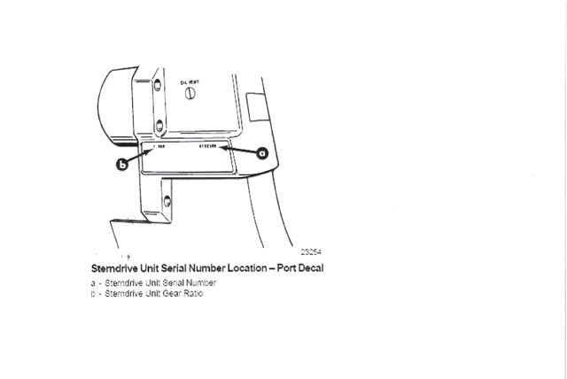

Get the serial number from the drive unit and post it here. The pic below shows where you should be able to find this information.
(a) is the serial number location
(b) is the drive ratio location
